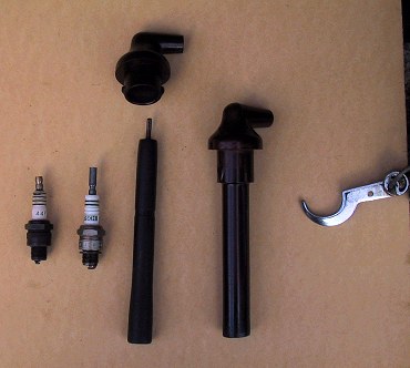

Picture on the right:
1. Standard spark plug
2. Plug fitted with 20 mm tube
3. Early two-piece connector
4. Later one-piece connector
5. Radiator attachment cam-lever, in which I have drilled a hole for the 'locking' wire.

One simply cannot count oneself as an Aprilia person without having experienced the G.A.E.S. - the Great Aprilia Explosion Syndrome - politely termed, for the purpose of this series, as a foible. One is driving along, invariably minding one's own business, when there will be a thunderous explosion from under the bonnet. Through the side louvers of the engine compartment will spurt slices of dense blue smoke, accompanied by a tinkling sound. As split second later, from under the dash, pours more oil-scented blue smoke.
Old Aprilia hands nonchalantly pull up, open the bonnet, retrieve the oil filler cap (source of tinkling sound) from where it has hopefully lodged somewhere around the engine bay. They then open the doors briefly, allowing the fumes to disperse, and then continue on their journey. The cause of the explosion is a stray spark from the Aprilia's long plug connectors igniting oil fume and perhaps petrol vapor in the spacious rocker cover and crankcase.
For many years I thought that the sparks ignited the fumes because of cracks developing in the bakelite spark plug connectors, but after trying perhaps a dozen connectors, I have another theory. I now think that the sparks originates from the contact point between the sparkplug top and the spring-loaded contact in the connector.
Aprilia bits
To reduce the chance of a gap developing between the sparkplug and the contact, across which a spark could jump, I fitted 20mm long extensions to the normal screw-on plug caps. This compresses the connector springs, preventing a make and break contact, and I have had a couple of years explosion-free motoring.
The proof of the pudding came the other day when, in an effort to start the car, too much petrol was poured down the carburetor, wetting the plugs. During the ensuing quick plug change, I omitted to swap over the plug extensions. Sure enough, within five miles we had experienced two big bangs. The plugs were quickly taken out, extensions put on and foible No.1 had again disappeared.
