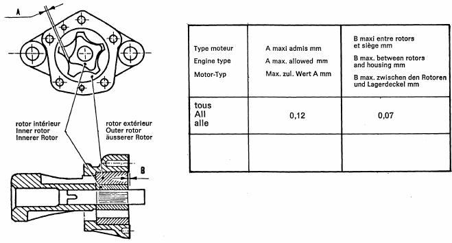

The picture below is copied from the technical Databook of the Fulvia.
The table lists the maximum values for the clearances between rotors (0,12mm max) and between rotors and cover (0,07mm max). These clearances are maximum values. If they are exceeded the oilpump has to be replaced. Most Fulvia's run with oil pumps that have even larger clearances which results in low oil pressure and low oil supply to crankshaft bearings and camshafts.
We rebuild Fulvia oilpumps to clearances which are half the value of the clearances given in the table. High precision new rotors are precision ground to within 0,005mm. Also the housing and cover are precision ground. Even the inside bottom of the housing (which is really the top of the oil pump as it is mounted upside down) is precision ground using specially manufactured tools.
