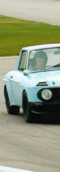

Sep 18, 2003,  Paul de Raymond Leclercq, London, UK.
I have owned a total of nine Lancias over the past 21 years. Amongst these have been six Fulvias, a Flavia 2000 coupe, a Delta and a Dedra. I have owned my present Fulvia since 1988. My previous Fulvia special was written-off in an accident (not my fault!) and I bought my present car from the legendary Harry Manning, just before his death. It was a candidate for the scrapheap, being mostly rust and body filler.
I am a lover of specials and so this car, chassis number 818331 002007, has been built up as a rather radical special - most of the original panels were scrap anyway.... I was able to salvage many of the special parts from the previous car.
To summarise:
Chassis/body: stripped. Rebuilt with rivetted aluminium wings; various strengthening carried out. Roller bearings to front springs instead of rubber. Solid bushes, specially-made gas dampers at front, 2000 anti-roll bar, Revolution 7" x 15" wheels, Yokohama A032R 205/50/15 tyres. FIAT 20V coupe Brembo calipers with 310mm x 28mmventilated discs. At rear, extra leaf to rear springs, solid bushes, special anti-roll bar. 6J x 14 Cromodora wheels, 032R 185/60/14 tyres. Brakes, Dunlop, lined with stainless steel, EBC pads. Discs thinned to 9mm.
Engine. 818540 8246, 82.2 x 75. Gas-flowed head, special home-made exhaust manifold, ultra lightweight flywheel. Lucas mechanical fuel-injection (ex Ford-Cosworth FVA) driven from modified rev-counter drive. Special throttle bodies. C. 145 BHP at 6750 rpm. Alfa-Sud cross-flow radiator with remote header tank, oil cooler ex Delta HF, fuel cooler in return line.
Gearbox standard SII 818740.
The car is sharp-handling, and at Goodwood, is faster than the owner, demonstrated this year when a racing driver with no Fulvia experience managed a lap in 1:41.8, adding that he thinks that there are another 3 seconds to come.
The picture shows the owner at Goodwood in the chicane, the other pics, the engine compartment (after seven years a bit untidy) with the fuel injection installation.
